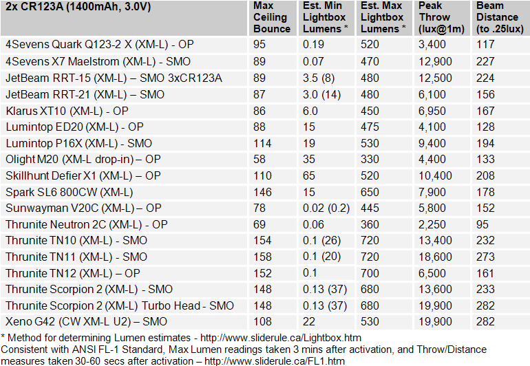

    来看下CPF上老外测得几支筒子的照度http://www.candlepowerforums.com/vb/showthread.php?311102-Thrunite-Catapult-V3-(XM-L-2x18650-4xCR123A)-Review-RUNTIMES-BEAMSHOTS
    看Peak Throw(lux@1m)那一栏
    SR90NB,100500lux 弩弓V2是46000lux
    另外一篇测TN10 ,用2XCR123 1米照度是13400lux
